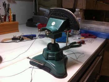

I'm thinking the thinner jaws, like the first pic would be best for sheaths. Might not matter that much, not sure. Here's the pony I used tonight. I was looking at one of my bench vises first, then remembered I have a little hobby vise. It actually worked ok.

That vise looks like a winner too! Far more simpler to store when not being used.

Thanks Chuck, I'd been leaning towards that design anyway, nice write up. I think I'll build one soon, my little vise worked ok, except it has about 10 places that catches your thread while lacing. I spent more time fiddling with thread than sewing!
