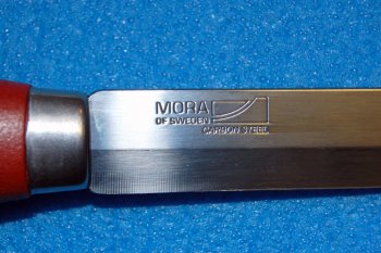

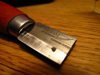

I know there is no way of knowing for sure by looking at a pic but I'd like your guys to give me me your best guess as to why this blade broke. I have a pretty good hunch but don't want to taint anyones thoughts. These are completely different knives. I just posted the pic of the unbroken blade as a reference.

I also think stress riser from the deep grinding marks on the blade up through the stamped logo.

Nice Picture , Darrin
No doubt be Stress related to the Logo/Stamping.
I'll be a Monkey's Uncle if it Ain't :D

You are right that the design envelope for the blade was exceeded, but my take on this thread from Darrin, is where it broke when it did fail, and that it might have done better without the deep, straight logo line.
Since this blade in the picture snapped along that long line on the right side of the stamped logo, I think a stress riser from said stamped logo surely played a part in the blade's breakage.
It looks to me like it was used as a pry bar. Any knife that is correctly heat treated will break if used to pry.
