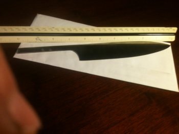

Right now I want to successfully make a wa handle. I like how they look and am curious about how the knife feels in the hand.
Its a challenge that I want to overcome.
I started on my first attempt yesterday, a purpleheart and of all things blue corian ferrule. I happened to have some of each handy when I started.
