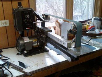

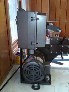

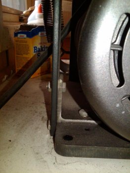

I used the KB Electronics KBAC-27D on my GIB. It is the VFD that Beaumont Metal Works sell with the KMG, which a friend of mine has, so I knew it worked. I know nothing about these things, but the VFD was very easy to set up and works perfect. One phase in and three phase out to the motor. It has a NEMA 4 enclosure and can use either 110v or 220v single phase (ie household current.) If you use 110v you'll be limited to a 1 1/2 hp motor. I use a 1 1/2 hp baldor 3 phase 3450 rpm motor. I bought that because I thought I would be using the 110v current. But when I went to wire it I discovered that the gauge was too meager for the motor, so I had 220v put in. So I could have used a 2hp motor, but frankly the 1 1/2 has been fine. Make sure when you buy a motor you get a 3450 rpm three pahse motor. The GIB is a direct drive unit and 1750 rpm is too slow, or so I was told by the designer. If you get this VFD, Beamont Metal works has a tutorial on how to wire it and set it up that is very helpful. I've attached a few pictures of how I set it up on my GIB.IMG00013-20110312-1019.jpgIMG00012-20110312-1018.jpgIMG00010-20110312-1017.jpg
