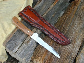

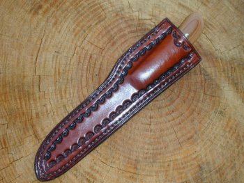

Travis E. Daniel
Saddle stitched and stamped, thanks for looking

Travis your sheaths are really awesome and the knife is great too. I had the impression for some reason that you were just getting started on sheath work side of the knife making from something that was said in one of your posts I remember seeing a couple of months ago or so. If that is true you are a fast learner, because your sheath work reflects a quality of some one that has been doing leather work for years.
Keep up the great work because you are really setting the bar high! :35:

GrizzlyKnives, After the stamping, the sheath is assembled and sewn. I hand stitch using the saddle stitch90% of the time. After sewing, the edges are trued up and sanded to a 400 grt, then rubbed out with saddle soap and water using an old bed sheet. A light coat of neetsfoot is allowed to level out and dry, then finished off with a coat of neat-lac. thats kinda quick for an explaination, but its really how i do it. I hope you guys like what i do
C Craft, I have been making knives for longer than i care to post here, but the leather bug really hit me about 4 months ago. I AM new to that part of the knife making. I teach basic knife making at Montgomery CC in Troy,NC as well as an advanced class. I actually study leather working just like a school boy and look for an excuse to pound some leather around something.. Mr. Paul Long is my HERO and the man has really helped me progress to the point i am now. If I can make one or two as good as his, I can die happy. Still have a long way to go. And thanks so much for the kind words

Travis, it's the NeatLac that gives your sheaths that soft glow, I really like them. I might have to pick up some of that and give it a try. Any pointers for applying it properly?
Sandy, been trying to come up your way just to visit. Hope to see you at the next meeting.
Grizzly, i use a piece of saddle skirting cut up into little squares , and use a circular motion when applying
Grizzly, I'm almost sure Travis meant to write Saddle Shearling (sheep skin) when he wrote "a piece of saddle skirting" above. It works out to be a nice soft sheepskin pad for applying both the TanKote and the NeatLac (separate pads for each).
