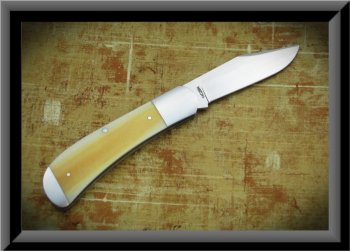

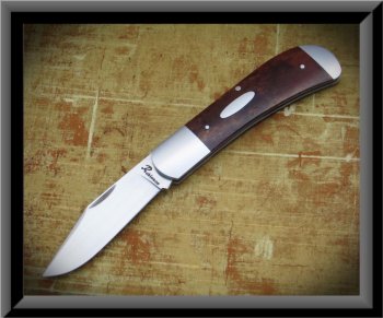

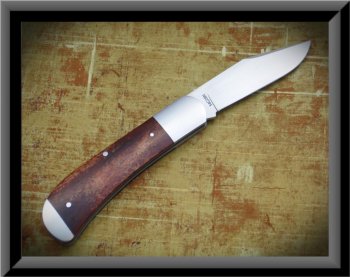

I've always wanted to make a Lannys Clip so I made these two for the upcoming Little Rock show.
I used Sandvik 14C28N for the blades and springs,416 stainless for the integral bolster/liners/caps,pins and shield.
They are 3 3/4" long closed with 2 3/4" blades.
The dark one has dyed bone for scales and the lighter one has antique Westinghouse paper micarta.
Yall enjoy!

I forgot to give credit to Lawrence Segal,"Rhinoknives" for the antique Westinghouse paper micarta.
THANKS LAWRENCE!
THANKS LAWRENCE!
Calvin, Beautiful knives. I'm so happy to see you able to use the Micarta on one of your fine folders. It will look even better with age as it patinas.
