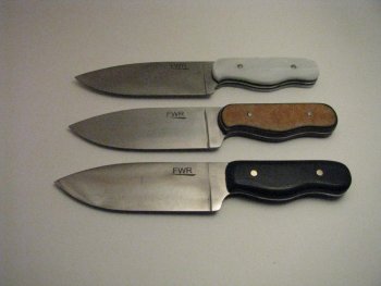

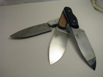

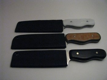

I have three sisters so I though I would make them each a small kitchen utility knife . I 'am not happy with the flat grinds , they seemed difficult to do on such wide blades 1.65'' and thin .075''. I ended up with some dipesduddles.IMG_3298.jpgIMG_3299.jpgIMG_3301.jpg

It takes a few to get the hang of tall full flats on knife. Some of one are 3" tall.
I drop down in grit size and do a few more passes to smooth out any dippy do's. Another technique is to roll the blade just slightly on the platen as you get toward the cutting edge giving you a slight con vexed contour and smoothing things out.
The proof is in the cutting & chopping.
I am sure your three sisters will love them and you.
