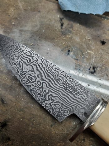

I'm not sure about the non-ferric alloys in the mix but isn't it just the coolest look?
Williams makes good stuff. I bought some of his DAM100 Billets (guess he discontinued them) he was selling that for only $28 a billet! I did buy the last 4 Billets he had. If his SS Damascus is as nice as his Hi-Carbon you should end up with a nice end product! This pic is the DAM100 Billet. My Billet did not come with any instructions either. I just emailed him my questions and he got back to me.
