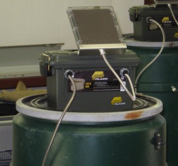

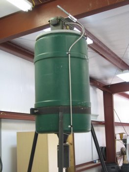

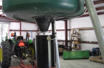

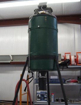

I have five wildlife feeders that I keep running all winter long,these,On Time, brand feeders are good but they require 10, AA batteries and they must be changed every four to six weeks,so...
I designd and built these solar power supplies,using a Plano shot shell box,rechargeable 12volt battery,12 volt solar panel and flexible stainless steel conduit,1/2" romex connectors and black RTV rubber. This is the second generation of these and I'm sure they will give me trouble free service for years to come as the first generation did.
I built the first prototype about six years ago,it worked well so I built four more the year after that. I'm still using the original solar panels and batteries,the only thing new is the ammo box enclosures and the flexible conduit.
These two in the photos are two new ones I built for one of my neighbors.

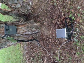

The reason I wanted a solar powered supply for my trail cam was because it has a big appetite for batteries and I'm off the grid at my cabin so no way to recharge the remote power supplies that you can get for your trail cam. I bought a remote power supply made for trail cameras and converted it to solar so it should stay charged all the time. I had to do some rewiring of the control panel in the power supply and also added the flexible stainless steel conduit to keep the critters from chewing up my wire. The only reason I bought the remote trail cam power supply,instead of building my own,was because it was on sale at Academy for little more than the price of the 12volt rechargeable battery that was in it,I will take a photo of it later and add it here.

Here's the one I rigged up for my trail camera.
Don't get a crick in your neck looking at it.:biggrin:
