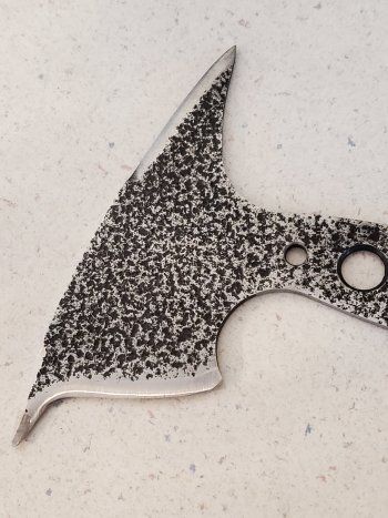

A friend of mine gave me half of a 24" saw blade it was heavily rusted and pitted. I made a Tactical Tomahawk for a Bounty Hunter friend of mine. The thing is brutal and the rust pits gave it an awesome texture and interesting look! I tested this thing on trees 2x4s an old door etc.. not a mark on it! I was worried about the spike, but no issues?
