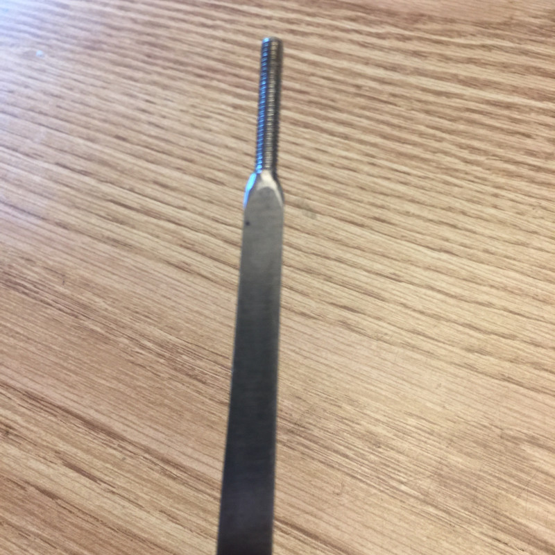

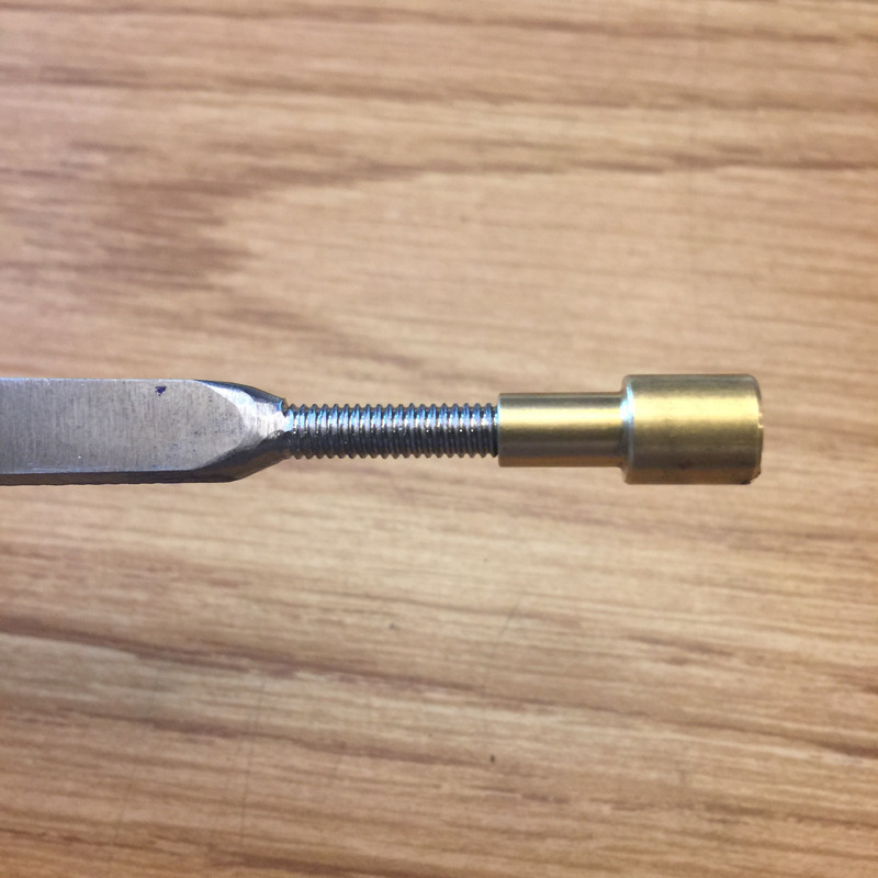

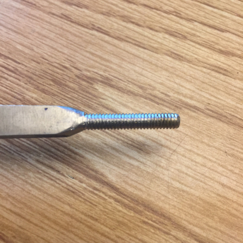

Here's a picture of what Chris was describing. I have done this a couple of times and it has worked well. If I remember right, a 6-32 thread fits a 1/4" corby bolt.
Yes that's what I was thinking! And I was gonna pien the head of the screw to fill the hole I drilled in the tang. Do you just leave it like that or put a couple tack welds on it??
I've done it both ways, tacked and not. I have seen or heard some discussion on welding on high carbon steel that it is bad, unless you heat the weld afterwards.
