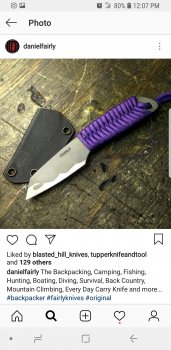

Warren Osborn used to make quite a few titanium blades with a carbidized edge. He was the only one I am aware of that made more than a few of them. The idea was to carbidize one side of the cutting edge and sharpen the titanium side and then the carbidized edge would be the cutting edge.
Today, many (most?) use a carbidizer for toughing the lock face (titanium side only) on a liner lock. I do this myself on every liner lock I make.
Daniel Fairly still makes Ti knives with carbidized edges he does what Tracy says grinds one side and caridizes the other here are a few pics I stole from his Instagram page.
