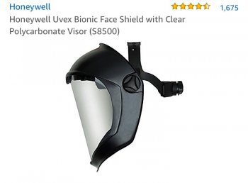

Welcome! and great question.
I like the 3M 7502 because it is supremely comfortable and gives a great seal.
I use P100 filters. (pink pancake style) because they fit easily under my face shield. My face shield is the Uvex Bionic. You can get it for about 30 bucks on amazon.
