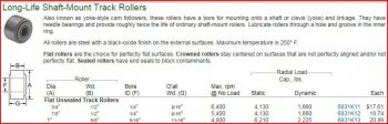

I need a bearing or roller that has the ability to handle an exterior load force. Such as you might think of on a material handler or conveyer roller. It seems no matter how I enter the search I can't pull up what I need.
I need a steel bearing/roller capable of handling a steel surface running across it with load. However it has to have a yoke style mount, in other words supported on both ends, (not a stud type mount).
Refer to this page, http://www.globalindustrial.com/p/m...mpaignId=T9A&gclid=CMWh3OmsnLwCFQto7AodeScA0Q
In the center is a stud type mount on the top right is yoke mount. My problem is I can't seem to find anything close to the dimensions I need!!
Approximate deminsions should be 1" length X 1/4" ID ( or smaller ID for shaft) X 3/8" OD (or larger OD). I would prefer to buy this with mount if possible. If not I can fabricate the mount!

This is what I am up to. I have a heavy gauge 2" square tube and a 1 1/2" heavy square tube, now we all know that one will slide inside the other. However there is little over 1/8" of play.
Well what I am working on requires closer tolerances than that. Thus the idea of roller bearing spaced along the outside of the tube should compensate for the tolerance as the small tube slides inside the larger tube, thus keeping the smaller tube centered in the large tube as it travels. The mounts will have to be adjustable so I can get the pressure right, and be mounted on all four sides of the larger tube, (NOT SHOWN ON ALL FOUR SIDES IN DRAWING). Sometimes my ideas are more trouble than there worth but, you never know till you try!!
