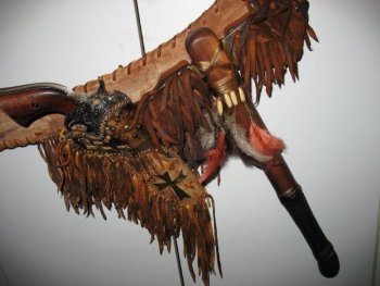

I kinda do the same thing that your doing . I purchase a big peice of leather and actually cut all my strips individually . I dont really try to cut them the same size and width ( I like the variation in widths ) I sew each one in place like you , and when Im done I hold the sheath horizontally and let all the frindges hang vertical . I then take a big sizzor and cut the tips to even them off. When Im done Ill take a bit of crazy glue and touch each stich just to secure it good. When the sheath sits vertical , the flow of frindge looks kinda nice . Heres a few pics of a few I did.. Some with shorty frindge and some with longer ones.
Shorty frindge
Long Frindge

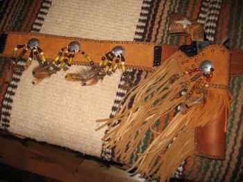

Hi Cliff. When I do a RH sheath like that, I use a X stitch and let it tie down any fringe as I go along, on the underside of rolled edge. I cut my fringe from garment suede cow, deer, or use braintan in sections of 2/3 inches at a time, leaving a border of maybe 1/8" for the tie down under the edge roll of the RH. Here's a photo, but it does not show the detail you might want

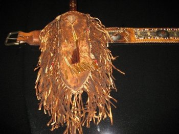

First one was sewed on after as was the second. The third was sewen and glued in with the welt as you can see the difference. KT

I would imagine it is time consuming cutting each and everyone of the fringe strips when done as a welt as you did in that third pic there Kid. Don't get me wrong because I love looking at your work Kid but, I think I like the way they hang better when individually tied in! They seem to hang more naturally down ward. Like in the first two pics!

Kid I just went back and reread your post and it say in the first two pics the fringe, "was sewed on after" ! Can you enlighten me a little as too what you mean by sewn on after. If I am understanding correctly you braided up the edge of the sheath then you sewed in the fringe! Is that right? Any further info on this process? I like the hang of the fringe better in the first two pics you posted>
They are sewed on after. One at a time. Just like you said. After braiding .KT
