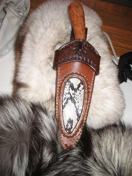

I have a question. I borrowed a picture from Ben Tendick. I hope he doesn't mind. What is the metal sticking out of the front of this sheath and what is it's function? It looks like a Sam Brown button but I can't see it's purpose. I appreciate your educating my ignorance.
I suspect the retention strap was folded behind the sheath for the picture, but I'm ante-ing into this thread to see what else it might be!
It's a belt stud. Really simple - you slide the sheath behind the belt and it either rides down to the stud, and stops, or the belt has a manner of a pierced hole-slot for it. Some have fancier slides that themselves ride the belt and the stud fits them.
Frank so looking at the Natchez on your last link, it has a belt loop with a ring the sheath slides into, and that button might be the slide stop. Interesting.
Thanks for the help Frank! The Desperado Knife and Sheath on the website you linked to really shows how it would work. Rob I am with you on the Natchez!! Really awesome. Now I got another question. With a large knife the belt stud will place the handle way up on your side possibly getting in your way and being hard to unsheath. Does that seem odd to anyone else? Reason I am asking is that I recently made a knife with 5 1/2 inch blade and about 5 inch elk taper handle. We have some big kitties and mean hogs on our deer lease and I want something to get them away from me.

The stud on the pic is either referred to as a Sam Brown Button. Here is a pic of two sheaths by none other than Paul Long, a master at his craft!
The one on the left is used with a frog, that is the part that has the belt loop on it and the whole sheath slides down into it and the stud acts as a locking device for the sheath. That way if sitting and the sheath is too long you for you to sit comfortably you just trip the front of the frog off of the stud and remove the whole sheath, leaving the frog with the belt loop attached to your belt, and the sheath in hand. When you arise from the sitting position, you slide the sheath back into the frog and secure over the stud. This use dates back quite some time! I think I have all my terminology and methodology correct in that explanation but, I am sure if not someone, probably Paul, since I used his pic :biggrin: will correct me!
The other application pictured is a retainer strap using the same type of stud!
I hope that helps to explain it much better than I could have with just words, see a picture is really worth a thousand words!!!!!!!
