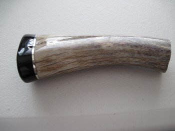

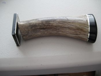

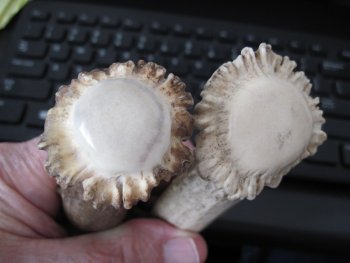

I have used lots of bone and horn, take it to 1000 or 1500 and use 3 M boat rubbing compound, it is not a grease based compound and you can get it out of cracks with a tooth brush wet or dry, I use 2" buffing wheels in my foredom don't get it hot,if you have light colored bone tape off the steel so as not to get the black from it, you can get the compound on line. Deane
Here are two crowns done with the 3 M compound with a nylon brush wheel in the foredom, the handle is elk drop horn, crack,s filled with super glue sanded and polished with the compound, the back is buffalo. Deane
