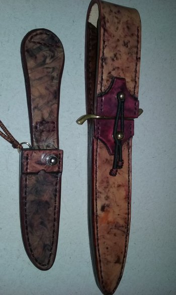

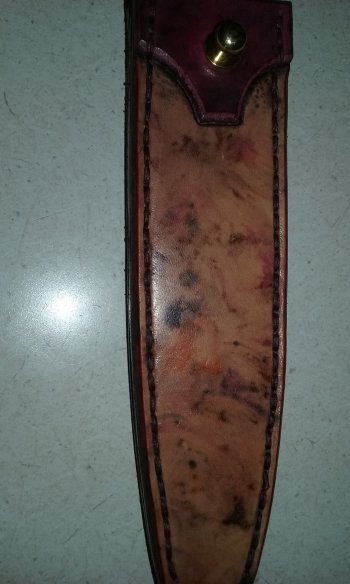

Playing around with different effects.
Nice work. The one on the right, is that how the leather is dyed? It looks almost like a burl.
Thanks.
Yes a variation on the shaving cream style of "marbelized dyeing". Instead of smoothing out the shaving cream and swirling the dye on top then pressing the leather into it I scooped some up (with a gloved hand) and just pressed it against the leather and left for a few minutes. Then rinse, dry, apply Bick 4. Wait a day then apply resolene to lock the dye in.
I have a one more that has swirls that I did the regular shaving cream way that isn't done. I used the leftover from that one to dye this one.
