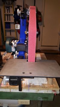

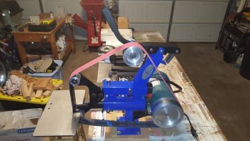

Had a personal delay but Grinder did arrive a few days ago. Hoping to have it together and running tomorrow. Very impressed with build quality and features.
I was able to get her together and running today. Hopefully by week's end I will be grinding.

You gonna enjoy your grinder!
