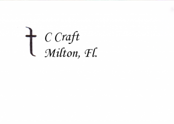

Gene, lets put it this way, IMO that is the best way to go! Name and some kind of contact info. I have no idea how many times on knife forums I have seen, do you know who the maker is that uses, a dragon, a japanese mark, a bear, a............................. Well you get the idea. I use this one,
in varying sizes! Not sure why it is not opening in a size you can see, but you can click on the file below and it will open to a size you can see. Mine doesn't give a phone number but you get the idea of letting someone know whoever made that knife you are looking at is the fella I want to make my next one!!

Anyway that's my 2 cents on that issue, others have many ways of accomplishing the same thing!!
