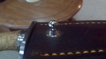

E epicknives Member Feb 27, 2011 #1 I am confused as to what this is and what its used for, and what size leather would you recommend? Attachments 2011-02-26_14-58-22_733.jpg 104.4 KB · Views: 21
Chef Niloc Well-Known Member Feb 27, 2011 #2 It's a button stud or Sam Brown stud. Used to hold a strap closed.
murphda2 Super Moderator and KD Blade Show Boss Feb 27, 2011 #3 It can also be used as a "stop" if you want to just slide the sheath through your belt or to work jn conjunction with a sheath frog.
Chef Niloc Well-Known Member Feb 27, 2011 #4 murphda2 said: It can also be used as a "stop" if you want to just slide the sheath through your belt or to work jn conjunction with a sheath frog. Click to expand... I did not think about that, good idea
BRad704 Well-Known Member Feb 27, 2011 #5 Haven't I seen those used without a frog, to go into a hold on your belt? (belt OVER the sheath, stud poking through)
C cappaletti Well-Known Member Feb 28, 2011 #6 as far as the leather is concerned (I'm guessing ur talking about the sheath)..use 8-9 oz.
