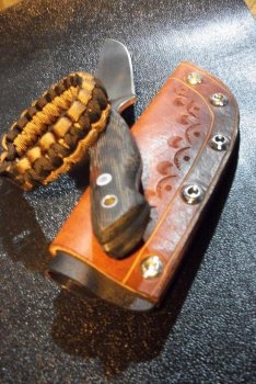

Love the way kydex works love the look of leather so came up with this. Its a proto so be kind got some work to do on it,but really want to see if it holds up well.
Any one ever see something like this before? Or heard anything about a cross breed before LOL :) Please all comments welcome.

That looks like a good design. Very attractive package overall, looks like you can go to town with the looks and still have an extremely durable rig. Are you cementing the leather to the kydex or holding it with just the binding posts? I've been using a kydex body with standard "snap fit" over the bolsters with a leather retainer strap paddle under the handle for awhile in some applications for dual retention.
i was going to glue but for now i did not, at this point you could still take out bolts and were the holes are in the leather there are metal gromets in the kydex so you could take the leather off and put a chain through the gromet and wear the kydex part as a neck knife. next time i might use your strap ideal if you dont mind :)

don go for it would like to see someone elses take on this,only suggetion i have is use the gromets in kydex then the bolt goes through them that way it will never tear out. Unless you fasten in a different way :p
Here are some thoughts -
The first few leather/kydex combos I did used a stack of a stainless acorn nut, a SS washer, the kydex/leather, then another washer and a stainless machine screw on the back to affix the paddle, in addition to eyelets on the rest of the sheath. That was ridiculous and I had to locktite everything. I recently changed to the "binding post" or sexbolt as the machine catalog calls them for all the connections, I figure it's basically a chicago screw with a drive socket or slot on both ends and the ones I obtained appear identical what I see in your picture. Running those through the open center of the eyelet/grommet sounds like an excellent idea. The binding posts are $0.90 each in galvanized and $2.60 in SS so I try to keep the usage of them to a minimum. Running both would allow a few less binding posts and the essential kydex fixture to be accomplished mostly with the less expensive eyelets.
