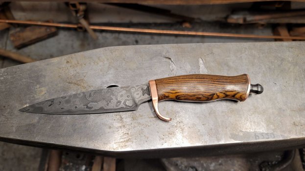

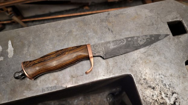

Leaf blade, copper fittings and bacote handle
I do like the copper in that knife - looks really good. I know you're an expert blacksmith, did you do the Damascus? Is that a San Mai blade? It looks really good.
Hi Ken, yes it is damascus done in house.. It's 18 or so layers with a lawn mower blade in the middle.. San Mai yes.. Good eye.. It turns this really super dark black color and the reason why I picked it.
It takes a decent durable edge but won't stay super sharp.. It will stay hair shaving sharp but not look at it and get cut sharp.

Did you bend guard before or after Shaping handle? And was it all together when you did it??
WIP = Work In Progress
Gliden07, Thank you.. Not great at texting.. don't know all the abbreviations..
The bend was done before the handle existed. I had in mind what I wanted it to look like.
No the bend was done totally on it's own over the horn of the anvil. Forged to shape as well.
