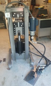

The start of my press
Well, I got the book to make one last week, but I like your start better than mine.
You will love it! I built the "H" press from the book by James Batson last summer, It is amazing the amount of work it does in a short time!!! This is my first attempt at posting a picture...
Ben , might I suggest that you get some high temp silicon rubber to protect the cylinder rod. When the cylinder is mounted below the work, scale will get trapped in the rod gland and eventually gouge up the cylinder rod.
