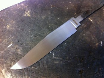

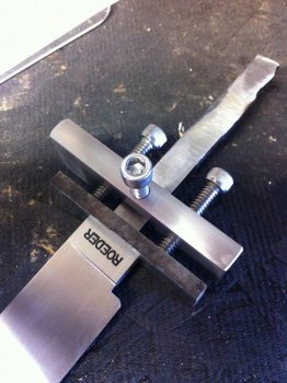

Ok, we'll its been a time since I've been in the shop making anything. Today I'm working on another of my ABS knives and thought I better get a shot of the guard clamp in use. Here goes :). Enjoy !!
Simple to use, and work great to help set the guard against the shoulders when using JB Weld or for soldering.

I hope these answer some questions ! If anyone has anything additional, please let me know. Thanks everyone !
