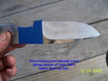

Thanks for the advice. I will get rid of the leather. Here is a look at my first attempt at the hollow grind. Looks like I need to follow through a bit more towards the end, but this is definitely an improvement over past attempts. I will send pic of the wheel.
