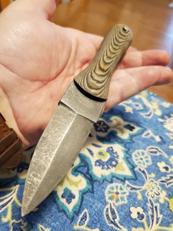

I made my first Dagger last year. I used 3/16". The other thing I did was mark the center line on the entire lenth of the knife, also marked the edge of the bevels both sides. This was to keep track of the grinds at all times. Another thing I did to keep track of grind was constantly cover where I was grinding with Sharpie again to keep track of my progress. This is a pic of it, the one thing I would change would be near the Ricaso I would ground sweeps into them to better match the style of the knife. It was a fun project!
