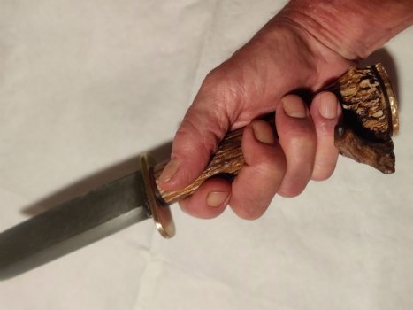

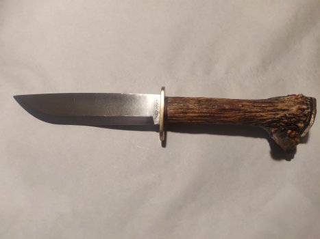

Since you folks gave good advice, here's my first Knife:
Blade: BRISA Leuku 180; 80CrV2; Scandi Grind; 180 mm length;
Handle: Oregon Elk Antler
Guard: Brass 360-H02 (0.1875”), with Bubinga spacer
Pommel: Brass 360-H02 (0.1875”), with Bubinga spacer
