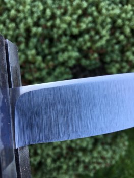

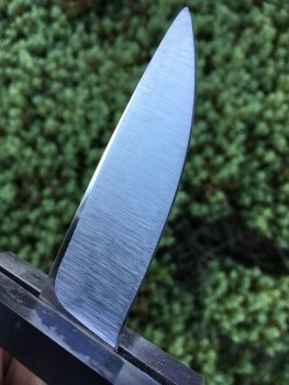

Ok here is where I got to just now on a 60 grit belt which I started with. Do I take the grind off the back of the spine as I’m doing here or should I leave a flat area at the top. Oh and I’m just grinding to a centre line, that’s my only reference point.
i have to say I found doing just this but a very natural feeling process and could easily see where I need to tilt the blank back and forth to walk the grind.
Hardest part for me is knowing if I’ve gone to deep with the hollow high up and running over the centre line when I chase the grind back down if that makes sense.

I always leave some flat at the top of my grinds- I just like the look of it
DITTO!
Also, it's always a good practice to leave a given about ON the grind until after heat treat. Exactly how much is up to you.....but always remember this.... You can always take metal off if needed.....but once gone, you can NEVER put it back. What's that mean? It means leave way more material prior to heat treat then you think you should. ;)
I forgot to say I grind in the fully hardened state so with that in mind is it ok to take a grind to the top?
also when you say to leave material at the top is there any rule of thumb as to the depth you would leave ?

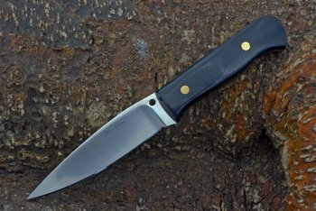

here are a few recent examples of the general style and height grinds I like on a deep hollow
View attachment 70873View attachment 70874
Very nice and thanks for posting. I see the way you do is I have done before which means a good contrast in the scratch lines.

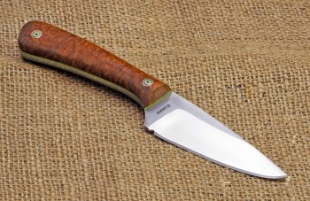

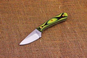

These are three hollows I did earlier, in the year only two were freehand though, wish I have stuck at I as like starting again. I think my issues with the one a few days ago was not 'owning the knife grinder and let it own me ' I also rolled the blade back n forth to much ;

Those grinds look good iza, and so do the knives as a whole. as for free handing, in my opinion that's what you should keep doing. I don't want to stir the pot here with folks that use jigs and guides because I've seen beautiful grinds using them but one way to look at it is if you have someone in your shop looking at a knife you just finished with a jig and is ready to order one right there...but, he wants the blade up swept with a higher grind line, will the particular jig your using give you the confidence to tell him 'no problem'?
The thing with learning freehand is that one day you'll be able to just stroll up to your grinder and confidently start grinding out a knife. and if you screw it up in the beginning, halfway through or towards the end, you'll also feel confident that you can make the proper corrections and in the end your knife will have real nice grind lines. sounds easy right haha !
The way I see it, learning to grind, your going to trash knives no matter how you make them so it's up to the individual on how they want to go about trashing them. you can get good with a jig or you can get good with your hands and skills.
As for the height of the grind, I strongly agree with Ed, it's a personal choice but the lines have GOT to be symmetrical on both sides. if your set up at a show and those lines aren't perfect you'll lose sales, and people at shows and folks that really know custom knives will be scrutinizing those grind lines.
Again, I'm not dissing folks who use guides or jigs but I think free handing gives you more freedom in changing up grind lines and fixing any mistakes that may occur while grinding out blades. :D
