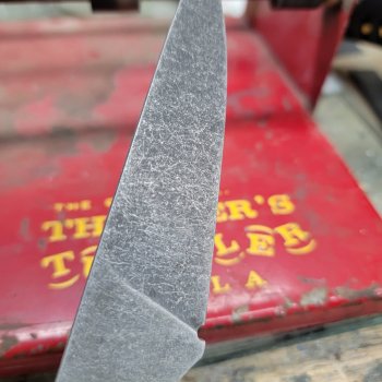

I'm just sick of paying for the newest thing. $60 a gallon plus shipping from Baker Forge for Gator Piss when the 2 main items are Hydrochloric acid and Distilled water to me is high. I have a quart of that Rooto drain cleaner I may play with. I did a stone wash on an 01 blade I'm working on to see if it would work. Nicest sone wash I've done IMO. Thinking with some tweaking it may work. I have a piece of Pakistani Demascus I've been using for guards. I have a couple knives that need guards so when I get on those I will make the guards out of that and give it a shot.
