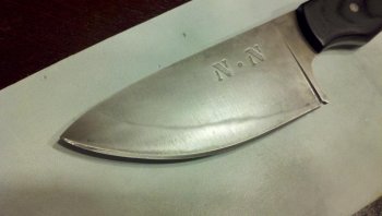

After quench I finished the grind and etched one the 1095's in boiling vinegar and then cleaned it up. it's got a very prominent hamon line from just behind the tip, 1/2in from the edge parallel to about a 1/4in above the base at the plunge. The hamon followed exactly where the blue coloration was. I think it looks very nice. While I know that doesn't mean anything about proper heat treat, the last 1095 I did, didn't have this. The older one was only noticeable at the spine where it got darker (I would assume this means the older one got harder to the spine than this newest one).

EDIT: oh, and what I thought was wierd was that the blue temper color didn't go all the way up to the spine. As stated, it followed where the hamon was. Is this normal? This one is going to a close friend, so at least I might get some good feedback on it.

I did fail to mention that I dipped this blade, edge first, in the quench with the intention of creating a more uniform line on this one. It appears to have worked, as for the line...now I'm more worried about the temper and the hardness. Unfortunately, I've got no idea where I can have this tested locally.

I don't know if the pic will tell you anything, but here it is....wish I got the line a little further up the blade, but oh well, it'll work.
For one, you need to separate the heat treatment for the 1095 from the 1084. With your forge setup it would be hard to be consistent but I would heat the 1095 at a slightly lower temperature for a little longer than the 1084. I take it that you tempered one of the 1095 blades at 425° and the other at 500°. The 500° sounds a little high for 1095 unless you are trying to make a tougher blade at the expense of strength. If that was your goal I would recommend a steel like 5160 that was designed to be tougher in use than the 1095. The 425° with it sounds a little better for general use but something a little lower might not be bad for increased hardness, strength, and edge retention. Don't worry about the the bluish patina, especially if it was on the blade tempered at 500°. My suggestion is that you use the heck out of both blades to see how they hold up and let that show you what is right.
