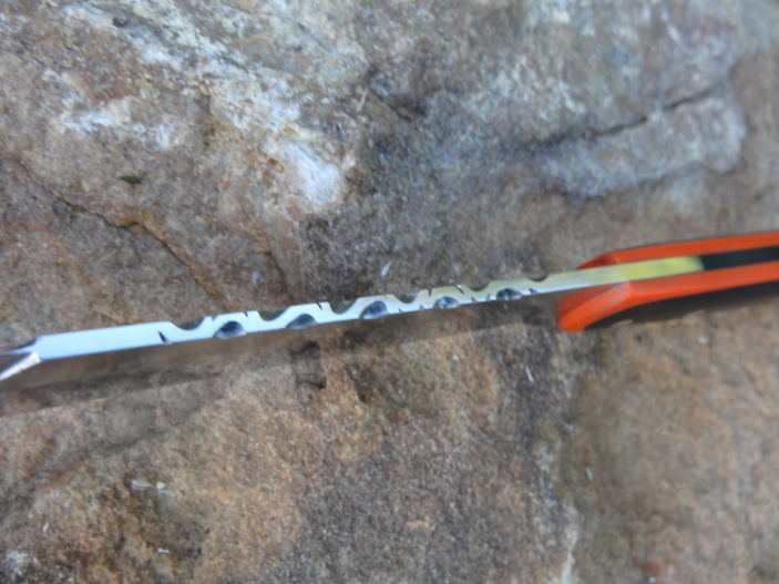

I did for the JD halloween Build Off a fixed blade a bit strange
The Devil Tongue
30 cm long : 16 cm sharp : 7 cm for the secondary edge
3 mm Niolox blade , under aluminium plate hardening to 1040°c (kept 25mn) , 200°c during 30mn x2 tempering.

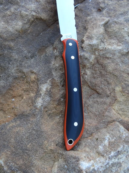

Half full tang building and G10 Orange/black handle
The Devil Tongue
