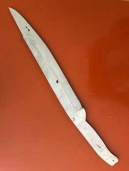

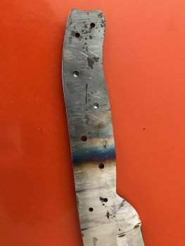

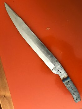

I fashioned my Bowie blade from a leaf spring and am drilling holes now for the brass bolster, handle pins, and brass end piece. I drilled the first few starting at the blade end and worked down the tang. The holes drilled without any problem. The next 2 holes will not drill! The blade was only heat-treated down to the ricasso area, so tang was not ever hardened. It was tempered x3 in the oven to straw brown color. The tang is soft to a file. I heated the area around the holes with a torch, as you can see, but it did no good. The drill bit won't go into the metal just for these 2 holes. I tried several different bits, no help. In the picture you can see the remnant bolt hole in the tang from the leaf spring which is now closed, but interestingly the 2 holes I am trying to drill are on either side of this.
Any idea what may be going on? Would appreciate any input. Thanks, Brian

if you chuck it up in a vise, you can use a torch to heat the trouble spots to a red heat to anneal the area. the vise will act as a heat sink. the blade will not be affected.
A new carbide bit will get through. Next time it may be better to go in this order. Forge—clean up profile—normalize x2–drill holes for tang--grind—Heat Treat. It will not guarantee you will not hit a hard place when drilling your tang but it should lessen the frequency nicely.
Get a cheapo masonry bit. It's carbide and will drill through. Then just throw it out as it will be ruined, but they only cost like a buck or 2.
Thanks everyone for the input. I'll try the masonry carbide bit first and see how it goes. The true carbide bits are about $20. Never would have thought there would be isolated hard spots like this, but pretty new at this.....
