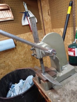

Place blade and stamp under ram of press. Letting the ram down enough to contact the stamp is all the weight it needs to hold it in place for adjustments:

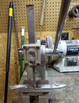

Check for straightness/lean/tilt:

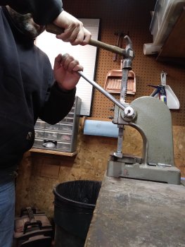

Apply pressure to ram arm/handle and give ram a good rap with hammer:

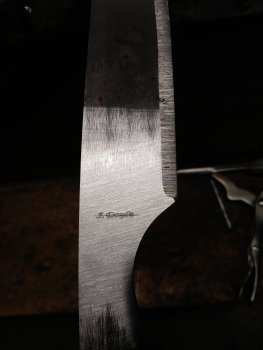

Finished mark exactly as stamped:
Some minor clean up from displaced steel from mark will be necessary. Thermal cycling/stress relief prior to quenching is highly advised.

Nice , what ton press is that? So do you press down on the handle and hit the top. Just once hard or several times?
1/2 ton I think. It was like $40 at harbor freight.
I put pretty good force with the handle and one good smack to ensure a deep even mark.
