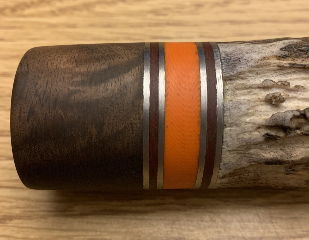

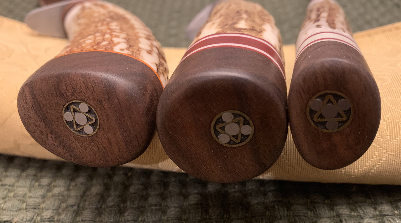

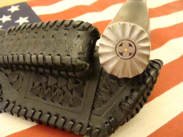

You have endless options. I use wood, brass, g10, stainless, mosaic pins, all kinds of stuff.
Thanks Dennis. How are you attaching them? Pins, screws? Beautiful work BTW.
The ones with the mosaic pins. I use the mosaic pin as a connector. I leave them 1/2, 3/4 inch long and put them into the elk handle. I usually use at least one more, sometimes two or three 1/8 inch pins drilled into the handle material.
