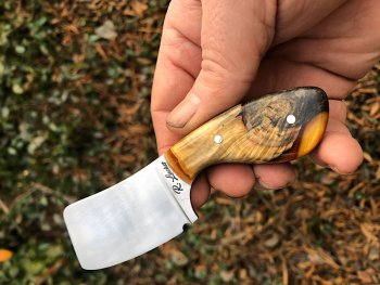

Randy - I have made one mini cleaver. I had a piece of 1/4 inch 1095 that was big enough. It was actually a bit thicker than .250. Like around .280. You could go stainless in the commercial environment. I know you can easily find 440c in thicker sizes. Not sure about any others. I do not use much stainless other than 440c.

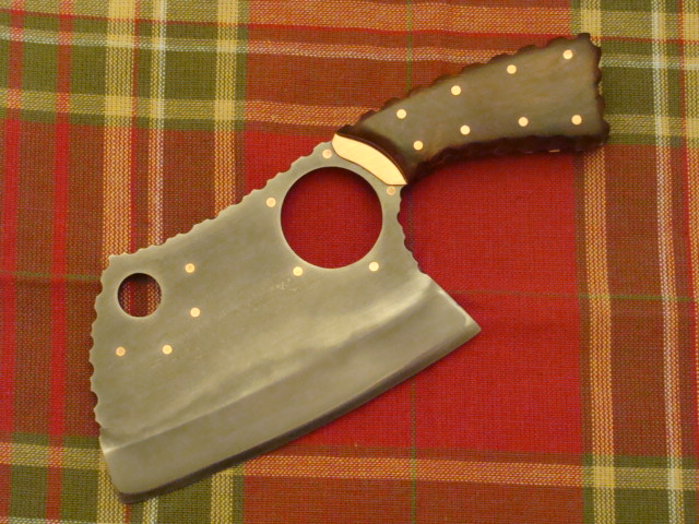

I made a few of these but I don’t think it will work. :)
