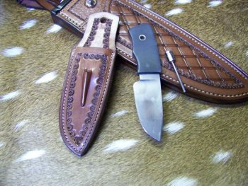

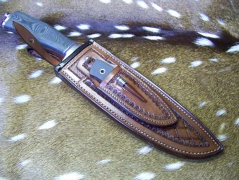

JDW here's a little set up I made for and take down knife and it's little companion piece. it hangs from the retention strap stud and the take downtool rides on the front of the little sheath.
Paul
Paul, that is nice pair of knives, and sheaths are great 2thumbs, thanks for the pics. Wish my sheaths turned out that good. What do you think of using a line24 snap to hold the small sheath in this kind of setup? Where do you get the studs like you use?
Thanks again, Dale
That's a Sam Browne stud from Tandy/Leather Factory, stock number 1309-02 in Nickel over Brass, or 1309-01 in Brass. You will also need the setting anvil stock number 8112-00. I have used these for about three years INSTEAD of the line 20 and 24 snaps. I don't believe I would trust a line 24 completely in this application. The stud is a much more positive lock up.
