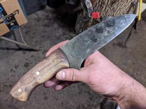

Hey I picked some of this 50100 up the other day. I quickly made a blade (attached) and I quenched in canola.
The product page and some other resources online said oil is fine for the heat treat. Does anyone have experience with it?

I did some tests on the 50100 today using canola and brine. And both.
My blades are all 1/8 of an inch or less. It seems cold canola oil quenched them just fine. I broke a piece that was oil quenched and the grain looked lovely. I think brine would perhaps be too harsh. I'd rather have a slightly softer knife than wrestle with warping or cracking.
