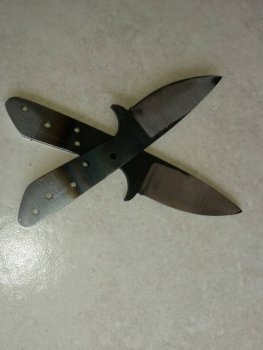

I don't what was different, but the first two small knives I heat treated with this ting worked great! Did them both in about 15 to 20 minutes. Got both up to a dull cherry, checked with a magnet, held it there for a bit and quenched. They got hard. Tempered to a straw color at 400 degrees.
I'm a happy camper. This was so much easier to setup, cleanup, faster, easier to clean them up afterwards. Hardly no scale or decarb.

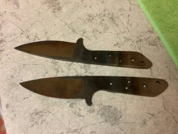

After temper
and after a soak in some ferric and taking a tumble with some rocks from the playground...
Looking good. How long do you soak in Ferric? I tried stone washing a knife a little while back, and maybe I soaked it too long, but it didn't seem like the rocks did much to the acid etch. The stone washing was pretty minimal. I was thinking i might try with ceramic media on my next go around.
-Aaron
I use to do a 5 minute soak, clean it up, soak again for 5 to 10 minutes, clean it up....then decided one day just to try leaving it in there. I now soak in ferric for about 15 to 20 minutes. Rinse with windex and water to stop the reaction, then go straight into the tumbler for stone wash (if that's going to be done), then I boil in water with backing soda to help keep the finish from wiping off.
I use playground gravel, but have a slightly unconventional way of stone washing. I only stone wash for about 20 minutes. I have a tall plastic container that can withstand everything beating around inside. close it up with the gravel, knife and a bunch of wd40. I then shake the container by hand, roll it around the floor, let the kids kick it, shake it some more. I call it a light stonewashed finish. It leaves the blade darker than grey but not quite still black with just enough bumps and dings in the color to look stonewashed.
