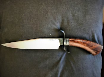

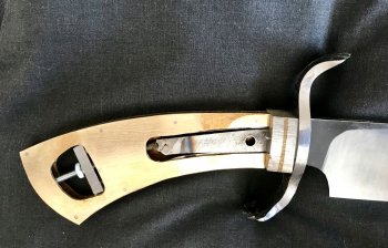

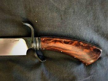

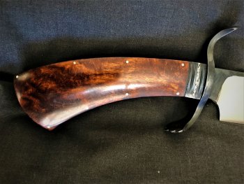

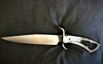

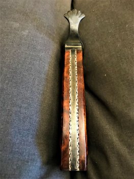

Finally FINISHED!!!!! Too many hours in this one to mention. 18th Century New Orleans Fighter reproduction with a frame handle. The specs are OAL: 13 5/8", Blade Length: 8 3/8", Blade height at Plunge Line 1 1/2", Handle Length: 5 1/4", Heat Treatment: to 1500*F and quench in Parks 50 with 2 - 2 hour temper cycles at 400*, Blade: 1075 with hand sand to 600 Grit satin finish, Guard and bolsters: 1075 and blued. Hand filed brass handle liners and bolster spacer, Handle wood: Arizona Desert Ironwood with 8 brass pins. The handle is a frame handle built around the knife tang and held in place with a bolt, lock washer and a nut encased in epoxy. (See photos). Let me know what you think. Thanks.
