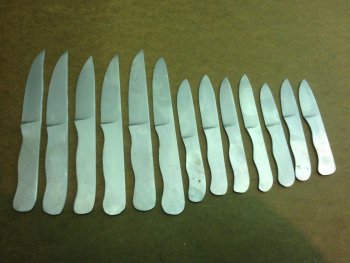

Saw a thread like this on another forum and hate to steal the idea but I thought it was a good one. I thought it would be nice if some of you guys popped in here every once in a while and shared a few pictures of what's going on in your shop, what you're working on.
I have been pretty busy lately and was able to go part time at the real job and close to full time in the shop. Still working out the kinks but I am figuring it out. Here are a few pictures of what I've been working on lately...
These have all been heat treated...
Experimenting with different finishes...
And finally figuring out the etcher. It was driving me nuts...
What's on your bench??
