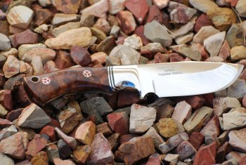

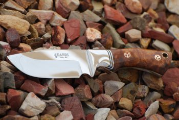

I tried your technique with he t-shirt and nail. The mark came out much clearer and cleaner however I can't seem to get it as deep as I would like. I was using the personlalizer plus set at the maximum setting of 5 when I did the etch phase as well as the mark phase. Thanks again for all of the help!!

The whole thing looks great, nice shine job.
Try kicking down the power to about mid level and make more slow passes. My average deep etch is at leat around 8-10 sloooow passes with a light recharge on etchant if needed. Sometimes I'll hear the sizzling sound but more often I can feel in my fingers if it's working, a real light vibration. If I don't feel the vibration, I use a tooth pick and put a drop of etchant on the pad. Take a look at some of my marks, they're plenty deep.http://knifedogs.com/album.php?albumid=35
The machine may make a difference, I experimented plenty until I found the right system. I'm using a Marking Methods machine with a wide power range but never exceed mid level or it cooks my stencil. I also found that the closer the ground is to the mark...the better it works for a deep etch. I usualy wrap the spine over the stencil with a small peice of tin foil so the clip doesn't scratch. All in all...everything looks great in your pics, I'm glad everything worked out but keep trying new things.
