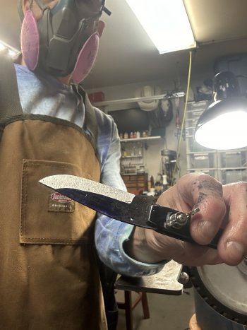

Worked on these guys! Got the FBBO finished up; 2.75" 80CRV2 blade, OD Green Canvas Micarta handles, black pins and lanyard tube and Kryptek Kydex sheath. The other one is my EDC 3 model with a 3 1/16" cutting edge 80CRV2 blade that is 3.5" tip to handle, with G10 camo handles, white g10 pins, black lanyard tube and Kyrptek Kydex sheath. Handle scales on both are fairly slim and I am playing with different contouring to see how they feel in the hand.
