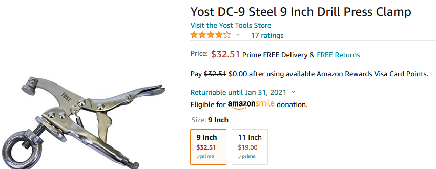

One thing I'll add is to set the piece against the stop before starting to drill so that it has no room to helicopter at all.. I've often used the post of the drill press for this very thing. With my belt driven HF press, when the bit grabs, the belt will slip allowing the motor to spin but the chuck won't. Perhaps this should be a selling point for lower powered, belt driven models...
I typically use a Hanson "Lockjaw" self adjusting clamp on the drill press. These things are worth their weight in gold for sheet metal work. No adjusting anything for different thicknesses, just clamp and go.

I agree these are terrific clamps. Kinda expensive, but worth it. Some folks have issues with the adjustment or getting their hand pinched in the handle. I've had one break in the adjusting mechanism, but I still like them.

I use this type of clamp in conjunction with the helicopter stopper clamp at about 10 o'clock. One of the best things I like about the clamp to the table is the ability to hold the work piece down on a punched hole with the drill press, and clamp very close to the hole with the other hand. The set up is fast and accurate. The big advantage to a clamp next to the hole is it positively stops the work piece from walking up or flexing enough to ride up the bit. That in itself solves the bigger part of the helicoptering problem. 5F2B7188-E85B-4B05-B107-F202D09B3D07.jpeg

Now you've got me re-thinking use of a hold down clamp. Like I said earlier, I've got one, but it's too big for my Walker Turner DP table. It is perfect for my larger Delta/Rockwell drill press. So, this morning I bought a smaller clamp that has a 6" throat. It will stop most knife blades from spinning within the clamping radius of the hold down arm and stop cork screwing.
And, thanks to Ed's suggestion, I think I'll add a foot switch.
Like Doug and Owl said, this is cheap insurance!

That's actually the exact clamp I have. I posted the Yost because it was the first similar image in google. :)
