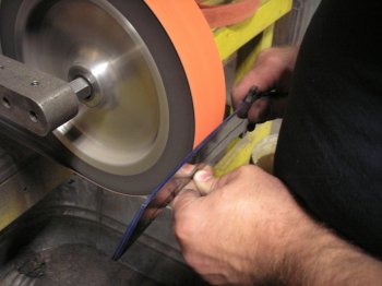

I do this the hard way as I don't have a metal cutting band saw yet. I nip off any large sections with cut off wheel on my 4 1/2" grinder, then grind to the line using my work rest and backing platen on the KMG. This is dirty and not efficient for thicker stock but I have to still invest in better tooling. You tear up the cold-roll platens into a grooved mess and your belt will occasionally explode. I use a push stick, welding glove, and a face shield, running the belt off the edge of the platen to clean up inside corners. I currently make this knife with a large top bolster/guard that's pinned from the sides instead of slotted and slid up from the pommel like a bowie as my first ones. That is a miserable fitment job with drilled overlapping holes and filing the interior square, especially without a milling machine on 304 stainless, so I do it this way now with the large top bolster. That is why the pattern doesn't show the guard protrusions the finished blade has, I scribe those in and try to keep them uniform. I'll make a new pattern reflecting the change at some point. Here's the finished work after awhile and some stainless swarf all over everything.

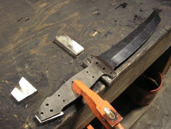

Hollow grinding to get the most of the metal off prior to heat treatment. I don't enjoy working these CPM super-steels after they've been hardened and tempered. I do leave some extra meat, about .075 overall edge thickness at the long trailing point as I've had it swing one way or the other during the plate quench and I'd rather be able to grind it back to center than try to repeat the process. I also didn't cut the end bevel in as I find leaving the spine or center thick all the way to the point on these tanto patterns ensures any distortion at the tip is minimal. I've had several end up shorter than designed due to wicked warp at the very tip. In spite of ourselves my apprentice and I were able to get good photos of this part. I'm pretty heavy set so my forearms lock in right on my hips with my gut over them and gives me a very tight and secure platform for the hollow grinding. No gloves or jigs here. The scribed center lines show in these photos. I rest the spine on the side of my bent first finger of my off hand, and I start right handed to let my somewhat smarter left side catch up.

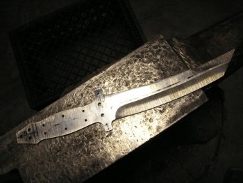

Here's the blade with the grind pushed up nearly to the final desired height, the swedge ground in, and the remnants of my bolster layout lines showing. At some point prior to hollow grinding I descaled the bar against my flat platen with a 120 grit belt as that stuff is really wicked to try to get back off if you heat treat it. On this particular type of knife I try to leave a large radius at the ricasso where the hollow grind rolls in. These also don't get a choil as it is rumored to be a stress riser and I suppose it's true. I also stay back away from the final depth and distance from the guard with the heavier belts as a slip can force a design change. This will be slow going after heat treatment but I'll be running finer grits and really watching for uniform, mirror images to the grinds.

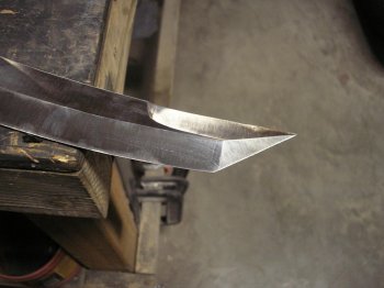

Looking good, I will be curious as to how you cut in the grind on the point. Will the ricasso area be trimmed back? It appears a bit wide by the guard.

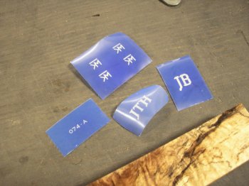

With the blade heat treated and the finish on it nearly complete, I tape it up so I don't damage it while I finish out the rough parts of the handle assembly. I progress through the grits from 100 down to 15 micron on the flats, then the hollows. At this time I also cut in the point, making sure the grinds mirror from side to side and the point is centered. Right before I tape everything up, I make the stencil for the custom etching, my logo and serial number, and etch the blade. After this, it's onto the bolsters.

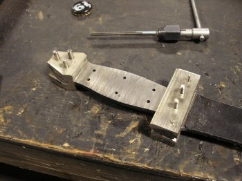

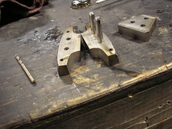

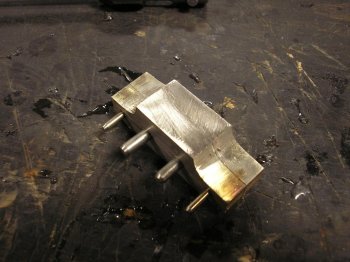

I used 304 stainless steel for the bolsters on this knife. I find the durability of it exceeds the other options even if it is harder to work. It's gummy and tough to drill but I get it done. Here's a section of 3/8" thick stock laid out, the bolsters are cut out slightly oversize with a 4 1/2" cutoff wheel on my small angle grinder. I grind them with my KMG and the flat platen, checking with a machinist's square to make sure I have the faces very flat, leaving a rough 60 grit finish that I then clean with acetone in preparation for temporary gluing. With superglue, the bolsters are secured to the tang and left to dry. Then, using a clamp to give added insurance that they stay put, I first spot all the holes through the tang with the 3/16" bit then drill them through. By spotting all the holes first, if the bolster spins I can finish drilling it off the knife and be assured my spacing will be correct. First one side, then back through those holes after the second set of bolsters is affixed. I put the pins through at this point and grind the bolsters to the same profile as the tang.

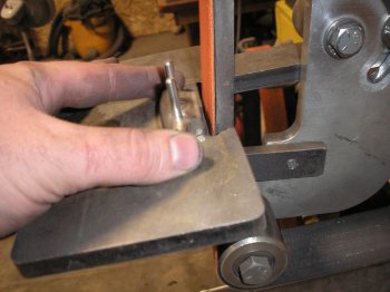

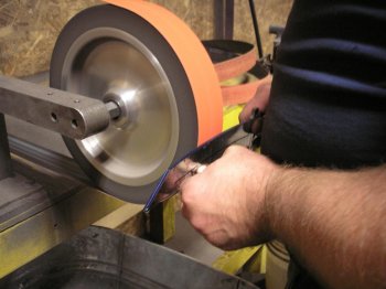

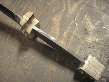

Now, with the bolsters flat and sized to the tang, I make sure the area that will bear against the handle scales is perpendicular to the tang. I use the KMG again for this with the work rest at 90 degrees to the belt. The front face of the top bolster needs to be finished before I mount it. I shape the front to it's finished profile then go through the grits on it from 60 down to 15 micron, then buff it with a coarse sisal wheel and white compound, then a softer cotton buff with green. This allows me to cut the miter next and have all the bolster angles match on both sides of the knife. After the miter is cut in on all 4 bolsters, I fit them to the knife with the pins and check to make sure everything is flush and lines up closely.

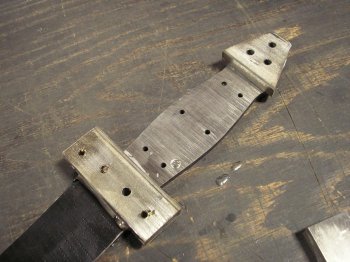

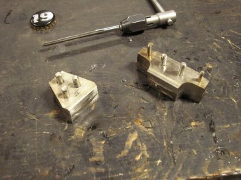

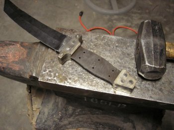

I peen the 5 3/16" and 2 1/8" pins until they mushroom. For added insurance on the smaller ones, I center punch them deeply after peening because I'll be shaping the outside of the bolster assembly extensively. This leaves a deep divot that will be ground out but assures the pin is blended well with the bolster material. After everything is pressed together to my liking, I shape the bolsters to very close to their final shape. This is an aggressive operation that puts a lot of heat into the handle and is best done before the handle scales are affixed.

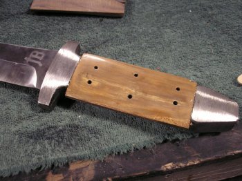

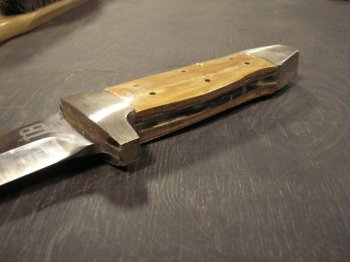

At this point I'm ready to put on the handle scales. They're carefully cut and ground to very close to the final overall length required to tightly fit between the bolsters, then I sneak up on the final fit using the KMG with the platen at the same angle I cut the bolster miter with. The ivory requires a slow speed and very fresh abrasives, as you can't get it wet to cool it. I work slowly and check the fit many times until I get them to slide in as far as I'd like. It's tough as they're rounded and want to rock back and forth, so there's a lot of incremental fitting here to get it tight.

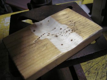

After fitting the handle scales into the miters, I epoxy them in place. When I drill the six 1/8" pin holes, I layer the face of the scales with tape and also set the handle into a rough hollow I ground into a piece of wood to support the face against chipping out. From here, it's pretty standard clamp and epoxy treatment for both scales after I rough up the 1/8" handle pins and slide them through the holes. I carefully saw these close to the handle to limit the grinding I'll have to do to level them out, as heat is a real enemy of natural handle materials like ivory. I fill any voids and cracks with thin cyanoacrylate glue and shape with a new 60 then 100 grit belt, being careful not to damage the material, and then final shaping using the flexible Norax belts at a slow speed. The handle is taken to a worn 45 micron finish, then buffed carefully to keep it cool. After the handle is finished, I go back over the knife with fine finishing belts to get the last few scratches and rough spots.

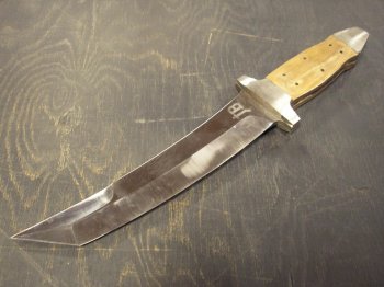

After some sheath work, which is another WIP entirely, the knife is done. I'm getting to be a big fan of the S30V and the ivory is very satisfying to work with. Feel free to ask questions or critique my methods - there is a lot of looking things over for accuracy, repeated checking, and elbow grease in my process.
