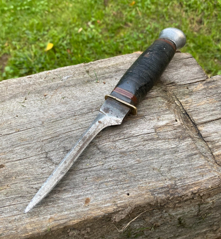

The trade off to the "snagging" issue for me is maintaining the FULL length and thickness of your edge as long as possible. With no dropped edge, your actual cutting edge gets slightly shorter and less usable with every sharpening, and you get into a thicker, less acute cutting edge much sooner. After repeated sharpening you get this type of prison shank monstrosity:
I'd rather extend my full usable edge for as long as possible and learn to change my technique to avoid snagging.

Is that a pic of your kith knife?
That thing was sharpened for decades using the back of an electric can opener. Remember those John? The can openers that had sharpening wheel inside of them, its more from your time than mine...
I remember my grandma had one. I'll give you that this was an extreme example.
