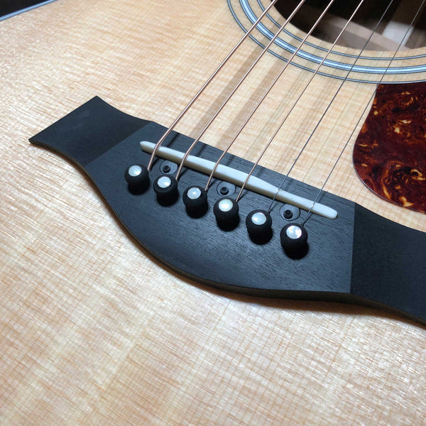

Pearl inlayed ebony bridge pins might work.
CD I may have to look into those?? They may work if I can cut off the end and counter sink it
I didn't realize how thin it was. I guess I was thinking of the crushed up kind mixed with epoxy.
Chris' picture made me think of "fast caps" in in cabinetry... or better, something similar to wood plugs for building furniture. I can picture a clean tight fit.
