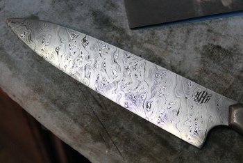

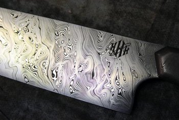

New HHH makers mark. What do you guys think?
:) We got this thing dialed in and making some really nice marks! Thank you again brother!
This is a 10" Chef blade, and I used the pic with the lighter in it for scale.. lol

Just working on some knives and got to use the new mark. Its working better then I ever expected!!!
