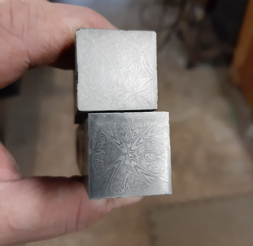

Me and my buddy did an interesting experiment:
We layered up two identical billets. One we ground every piece clean and one we grabbed pieces right out of the box and did absolutely nothing to them. They both welded up perfectly. The only noticeable difference was the little black lines/inclusions on the edges of the non-prepped billet went a little deeper into the edges and took a bit more grinding to get rid of them. But neither had any weld flaws.
Me personally......I usually only grind the burr from the shear on the 15n20 off so everything stacks tight. I don't grind or do anything to the 1084. No cleaning with acetone or wiping with anything. The only thing I would address is if a saw a big rust spot. I'd grind any piece that was rusty. But mill scale I don't worry about at all.
I try to make sure my two outside layers are always as thick as possible.
A good grinder finish on the restacked pieces is fine after one weld. Personally, after the second weld, I surface grind all my restacks.
I am of the opinion that dry welding gives you cleaner, better and stronger welds than Flux welds.
Don't get me wrong ......fluxed welds can be perfectly fine, good and strong, but there is increased hassle and mess at best and potential for flaws at worst.
