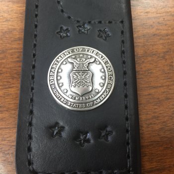

I have never put one in a handle. But a concho in the sheath may suffice. Like $5.00 at Hobby Lobby. Army, Navy, Air Force or Marines.

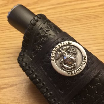

Another concho. How about a pin with a Navy theme?? Anchor maybe?? You can get just about whatever you can imagine in a pin.

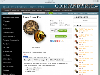

Somebody asked me to do the same thing. I found this pin. I feel confident I could inay it on the handle , but I'm not up to the quality on my blade making yet. Its army but I'm sure they have navy. It's the smallest I could find right now. It's 5/8 inch.
